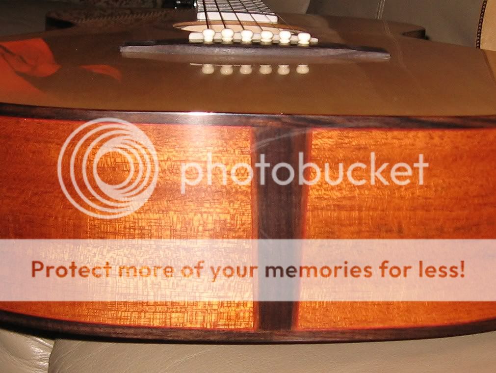

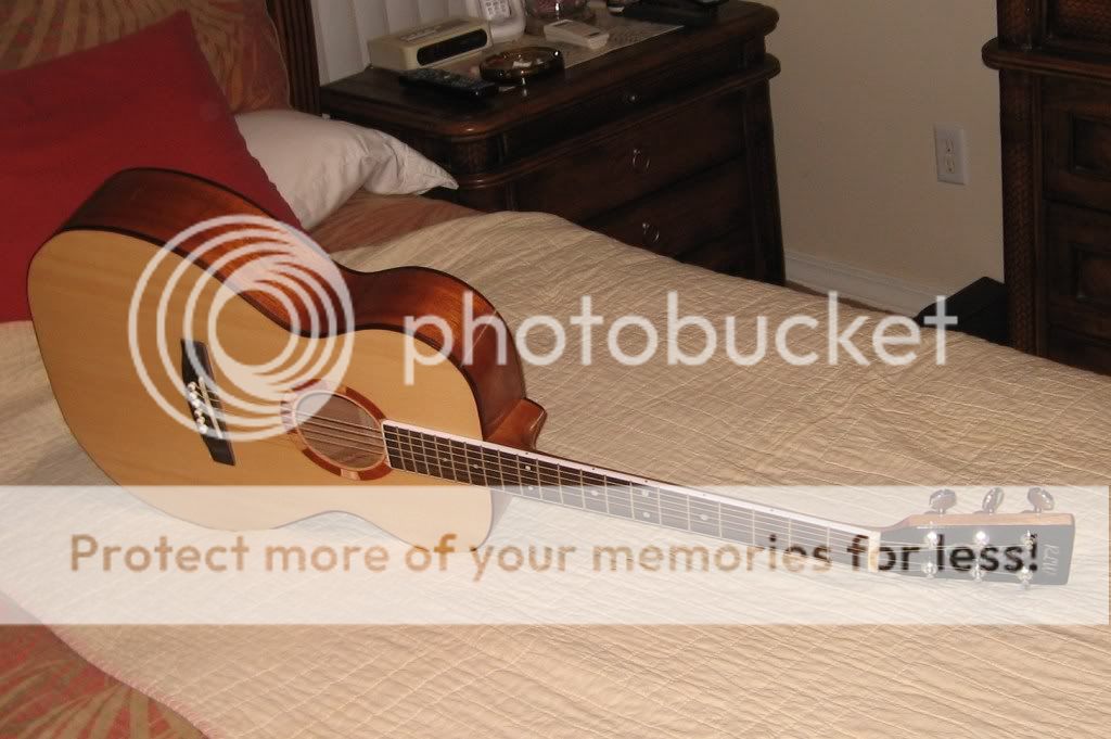

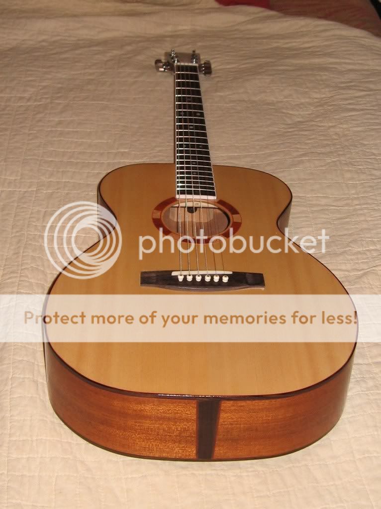

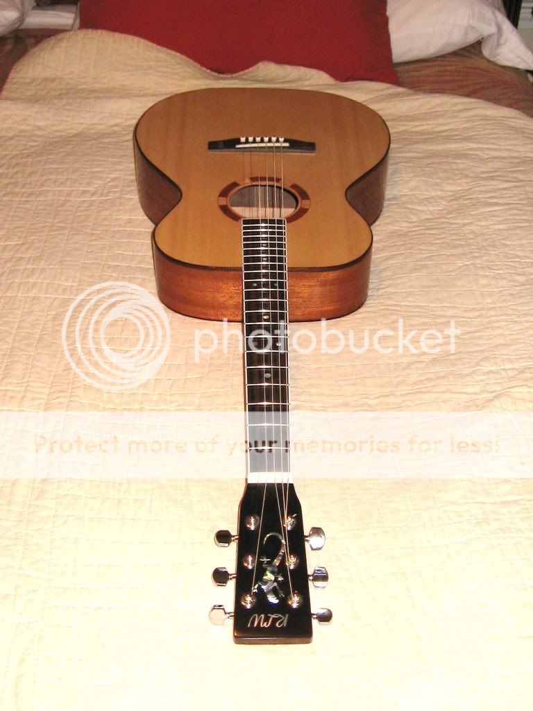

Built this for my buddy Bob, mahogany back & sides, sitka top, birdseye maple and padauk rosette, EIR binding with red purfling, rosewood fretboard and bridge, gotoh tuners.
Still needs to be buffed out but that will have to wait a few weeks for the nitro finish to fully cure.

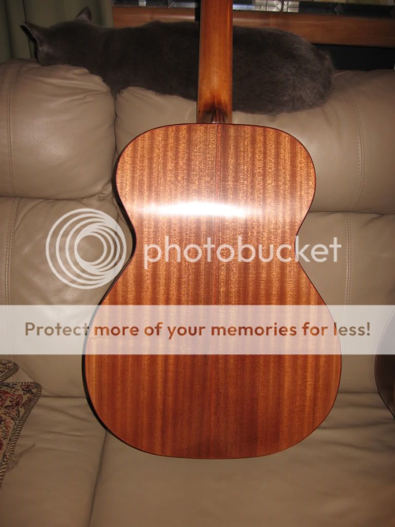

That's a beauty! Very nicely done.
What did you use to pore-fill the mahogany?

Zpoxy filler

Nice personalized guitar with beautiful "woody" look. Great looking fretboardbinding and headplate. You did great.

Bill, there you go, another one pore filled with epoxy!
Nov 24, 09 | 8:24 am
Yep -- I noticed. I obviously need some training on using the stuff. :-\

The rosette is the first one that I have made from scratch.
I have an abalone ring that I plan to use in a segmented rosette on my next build.
Bill, Zpoxy fills well but will clog your sandpaper during removal. YOu have to watch the color as well, if the Zpoxy is not even you will get a splotchy look.

When you say "if the Zpoxy is not even you well get a splotchy look" it sounds like maybe you are actually coating the wood and leaving a layer on the wood. Is this how you are doing it? When I pore filled with epoxy I only left it in the pores.

Woody because the woods used have a certain amount of grain. No plastics in the binding and rosette. The back has a knot and the top does not look "mastergrade"-clean. The guitar shows that it is made of wood. Me like.

Kevin, I did a wash coat of zpoxy after sanding to even out the color.
Nov 25, 09 | 12:55 pm
Really. So does the Zpoxy impart some color, like a light amber tone?
I find the cheap two part epoxy I use to be quite clear when dried.
Interesting! And you were able to get a nice smooth coat of the stuff, thinned out I am imagining? Cool.

Yes the zpoxy has an amber hue. For the wash coat I thin to 50% with alcohol it leaves a fairly smooth surface.
