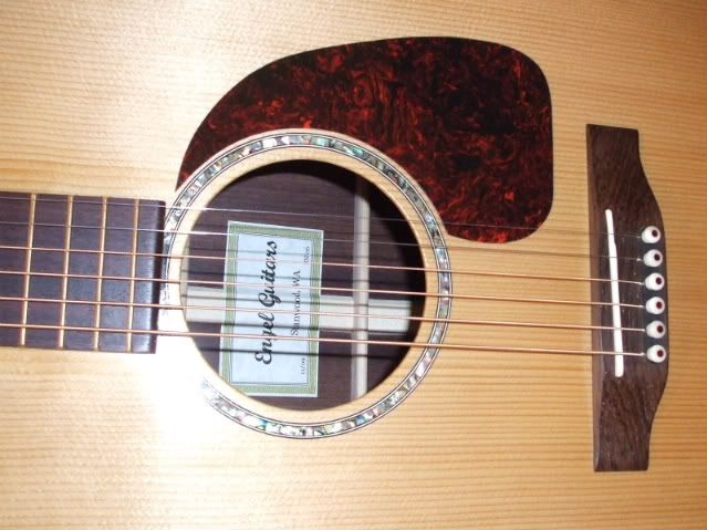

Hi everybody. I have two building questions for you all that I hope can be answered. Actually, I am sure you all can help. Who am I kidding, thats why I am here!
Anyway, here we go:
1) What type of paper and glue do you all use for your labels inside the guitar? They all look so professional it seems they were printed by someone.
2) If they were just made on your home computer, did you use a heavy stock paper, or just regular printer paper?
I am really jumping the gun here since I didn't even order my kit. I am doing that today with KMG, but I am curious.
3) I have seen some people have put a piece of cloth over the X-brace intersection joint. My Tak has it too and it looks like cheese cloth or linen. Whats the deal with that cloth? Is it needed? Does it help/hurt/have no effect on sound? I am guessing its a structural thing but as I am no engineer (I sometimes pretend I am an engineer with my son when we play with his toy trains, but thats a different type of engineer and it totally doesn't count anyway)
Thanks in advance for your help.

You can get the nicer paper at most craft stores.
The cloth is a reinforcement for the joint. It is the best method out there for this. I have never had to repair a cloth covered joint. I have had to repair too many wood ones.

Yes I make my labels out of nice looking regular to thin paper on a color laser printer, use school stick glue and call it good.
I don't use cloth over my X joint, reenfored with med CA... NEVER coming apart.
Dave

I have used gun cleaning patches in the past, and this time used a wooden disc to reinforce the center joint....either work well.
I have always used thin wooden braces on the sides, rather than cloth. I would just make a mess with cloth.
For the label, I use a high quality rag-type resume paper....had a little more of the antique paper look that I liked. I used my regular printer set to high quality, but I also sprayed both sides of the paper with clear acrylic before gluing it down. This kept any water from the glue from causing the ink to bleed, and helps keep the paper cleaner later.

I used cut outs from old tee shirts on my first few patches and then starting using gun cleaning patches that I purchased from Dick's. No notable difference in sound or tone.
As for my labels, I purchased sheets of business card printing stock from Stapels. I then print on my printer. I used wood glue on a few and on the last couple I have used transfer tape. I also use transfer tape to attach pickguards.

I used some fancy heavy paper, and printed it on an inkjet printer with settings to highest quality:
That X-brace reinforcement: it's not mentioned anywhere in the StewMac kit manual, I noticed.
Is that vital?

Capping the lap joint increases its strength to almost the same as solid wood. Not capping it leaves it VERY vulnerable to damage from impact, which will basically mean removing and rebracing the top. It also makes it more likely that the top will sink between bridge and soundhole. Remember that internally the joint is end grain and that's not good.
I use a short piece of spruce (approx. 1" X 1/8") to bridge the joint. Cloth is probably about as good; I just don't like the looks of it. Covering the solid side of the joint (by using a cross-shaped piece or disk) is redundant, unnecessary, and silly but if you want to, what the heck.
Same for the crack stoppers along the sides -- cloth, as used by Martin, does a fine job. Since I just don't like it, I use small sticks of left over back and side material. It's only a couple of minutes to rip and bevel them. It takes longer to fit them -- use a caliper to find the distance from lining to lining, transfer to the stick and cut. Fit them snugly between the linings since a side crack next to the lining is really hard to repair!
