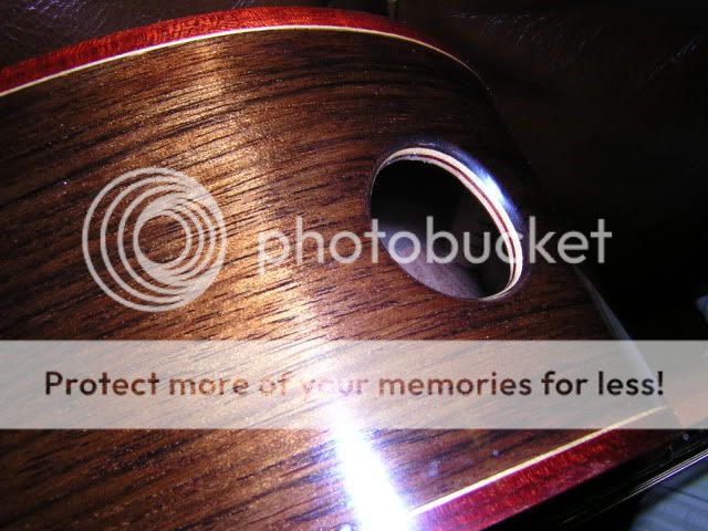

Here are a few pictures.
This is the sound port on the OM and this shows the layers
This one
is a shot of the layered veneers on the parlor I'm working on. I picked up some packets of different wood veneers at Woodcraft and have been using them for making these.

Ken & Tony,
The veneers bend along the grain very easily which lets me bend and glue them cross-grain to the sides which I think gives a stronger reinforcement. I glue all the layers in at the same time using hot hide glue. They are added to the sides before I glue on the kerfed lining. When I rout the port I tape over the inside of the veneer layers to reduce tear out.
Regards,
Ed
Aug 15, 09 | 3:27 am
Ed is correct -- since the veneers' grain is perpendicular to the bend, they bend easily even if 1/16" thick. At that point of the body, they do not in any way inhibit sound or transmission of vibration; in fact, they may improve it.
