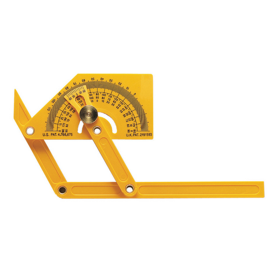

Davidmor, I guess I would just make the appropriat length on the shorter hinged piece of wood by finding the appropriate length using all that geometry stuff and double checking the angle with one of these?
