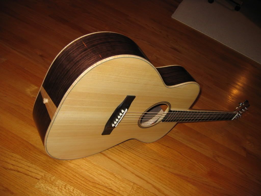

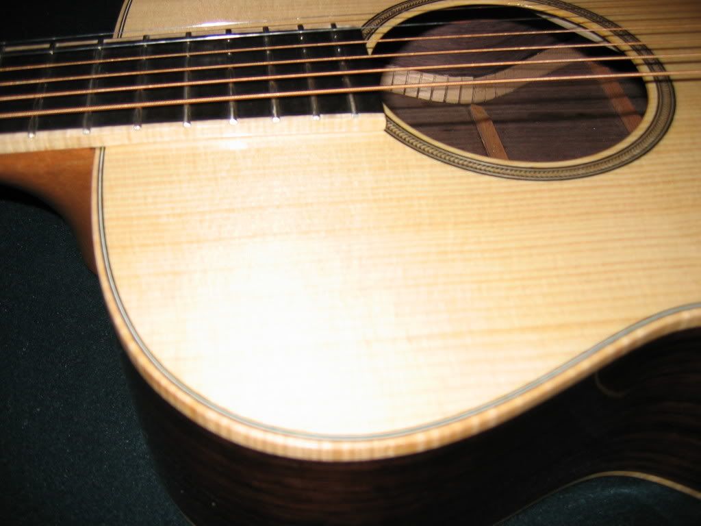

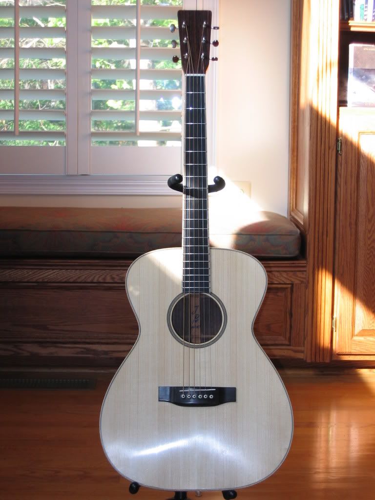

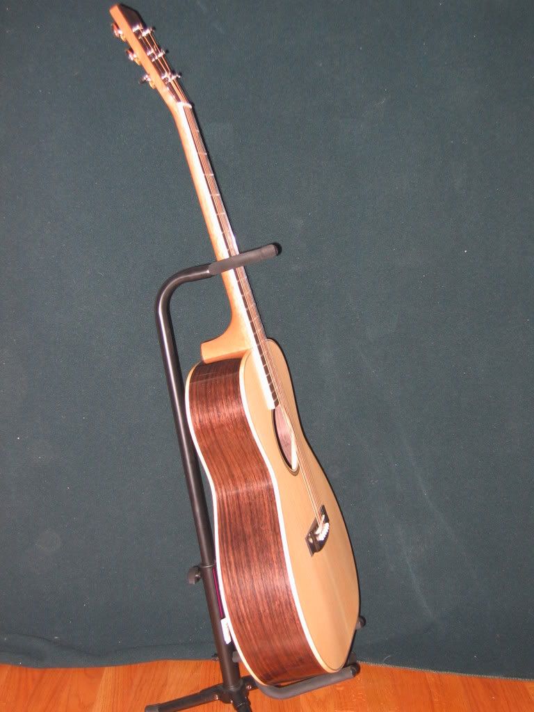

LMI's OM kit with E.I. Rosewood B&S, Adirondack Spruce top and curly maple binding.

Very nice!
Looks like nice clean work..
Well done.

Great work JJ! -- I really like that maple binding -- and nice finish. How do you like the sound?

Hi Bill----I love the sound of this thing, and was a bit surprised when I first heard it. It's a fairly loud guitar, with super resonance and great mids and highs. I'm particularly pleased with the way the mids and the trebles sound---really crisp and bright (something my Martin 000 lacks). The thing that really surprised me is the sustain it has, and I'm guessing that's gotta be the Adirondack. It really rings and rings and rings.

Beautiful work there! I especially love that adi top. I am a huge fan of growth rings showing in the top. My opinion is that the top is wood and it should look like it!

Great job JJ!!!!
What kind of finish did you use??Is the soundhole slighty bigger??

Hi Paul---the finish I used was the Hybrivar product from Target Coatings
(high gloss....12 coats on back & sides, 8 coats on top). It gives a nice warm tone after being buffed out, but I found it a bit difficult to apply, and that no doubt has to do with me and not the product (I brushed it). Knowing what I know now, if I were to do it again I'd cut it 5% or more with their retarder product.
The soundhole is bigger (4") than the LMI OM Plan specified (3.875"). Why I don't know...I got the serviced kit, and that's the way it arrived. It doesn't seem to have had any negative effects though. Who knows, maybe it adds something...the thing really sounds good.

Kudos, that is a fine looking guitar! The binding looks great and the bound neck is so classy!

Nice work JJ! I like the looks of the curly maple and that adi top has pizzaz. What's next?

Beautiful JJ, I am doing the exact same one right now with Koa bindings and herringbone rosette! My soundhole is also 4", interesting. You've done a beautiful job. Excellent work!
Oct 25, 07 | 7:25 am
I noticed thre are no fret position markers, are you a classical player by chance? Just curious, and again, beautiful job.

Regarding the fretboard markers on the OM I just finished----I decided as a matter of personal preference. I don't need them for playing as long as I have the small side position markers, and just like the way the fretboard looks without them. I'll put them on the dread I'm working on now because it may end up going to someone else.
Interesting about the soundhole on the one you're building. Sounds like LMI probably uses the same 4" dimension on all their acoustic tops, regardless of the particular style guitar.

I understand. I will be building the same guitar next spring out of australian blackwood with flamed maple binding. I do not intend on putting markers on the fretboard, only some artistic inlay, and fret markers on the side. IT does have rather purist look that way, doesn't it?
